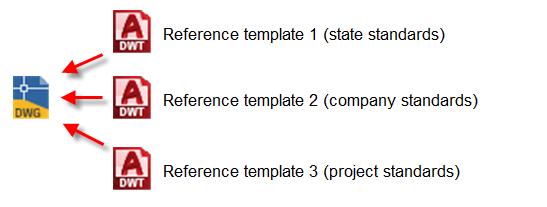

You can have multiple reference templates attached to a drawing. For example, you might have templates for state, company and project standards:
When you have attached more than one template to a drawing, you are alerted to duplicate components in the templates so you can decide how to resolve them. You can change the template priority order or choose to reference a component from a lower-priority template.
