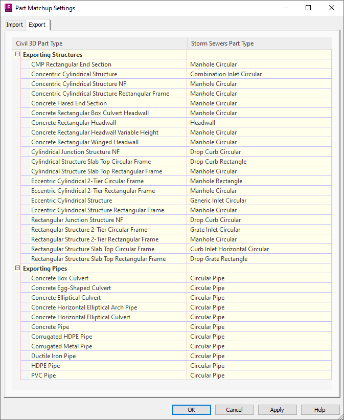

The Part Matching Defaults settings are found in the Feature Settings for Pipe Networks under Storm Sewers Migration Defaults.
Most users find that they get the best results when the Export matchup settings are equivalent to the Import matchup settings. Otherwise, a different Part Family will be substituted upon import.
The Export tab as shown below enables you to select any of the available Storm Sewers Part Types (on the right) to match to each of the Autodesk Civil 3D Part Types found in the current Part Catalogue. The Autodesk Civil 3D Part Types that are shown are updated based on changes made to the Part Catalogue.

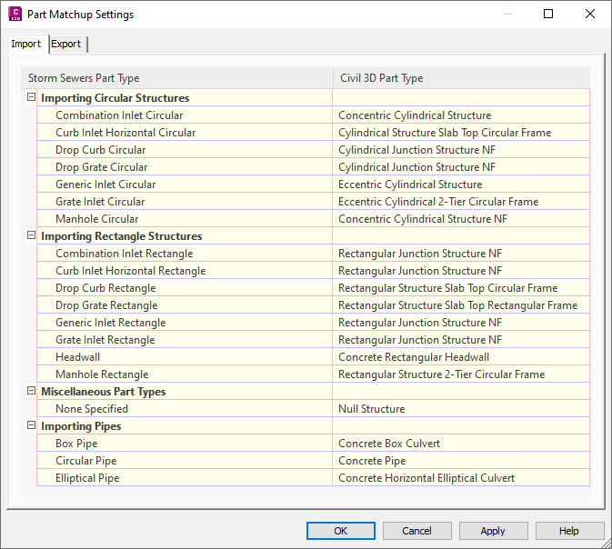

The Import tab enables you to select a Autodesk Civil 3D Part Family (on the right) to be used for each available Storm Sewers Part Type. The Storm Sewers Part Type is a fixed list. This mapping should be equivalent to the export mapping so that part families remain the same.
Most new structures in Storm and Sanitary Analysis will export as a rectangular shaped 4 foot by 4 foot structure in the STM file and may not match the same part types that were originally imported as circular structures (if Use Imported Part ID for Part Family is set to No). One possible practice would be to have rectangular Storm Sewers Parts and circular Storm Sewers Parts map to the same Autodesk Civil 3D Part Type, although if the setting are configured with that strategy, a one-to-one mapping between Storm Sewers Part Type and Autodesk Civil 3D Part Type will not be possible.

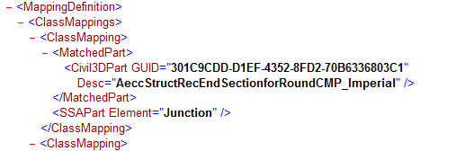

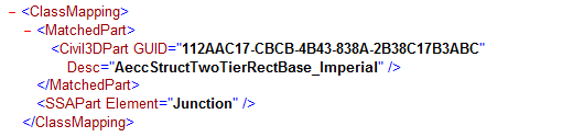

Junctions (or other nodes)

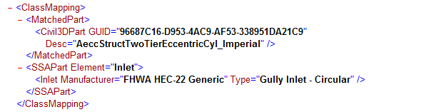

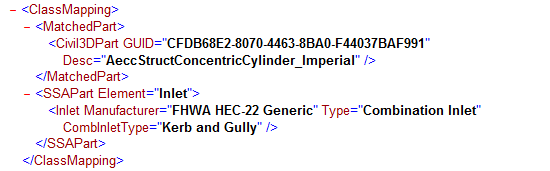

Combination Inlet

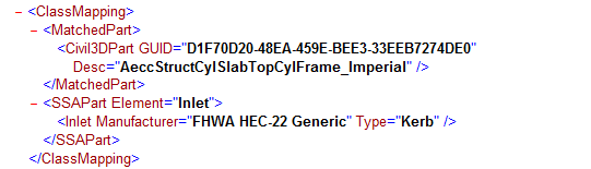

Kerb Inlet
Gully Inlet

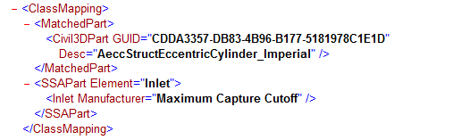

Maximum Capture Cutoff

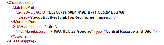

Central Reserve & Ditch Inlet

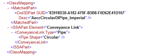

Conveyance Link: Pipe
The Conveyance Link Type could include: Pipe, Open Channel, Culvert, or Direct.
The shape will vary depending on the type chosen (refer to available shapes for each type inside Storm and Sanitary Analysis.)

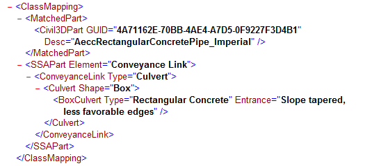

Conveyance Link: Culvert (with culvert type and entrance attributes)

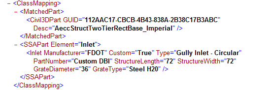

The Inlet element in Storm and Sanitary Analysis is a special case since there are additional "dimensional" attributes that could be used to map to a more specific cataloged part. More information is available in the SSA_Mapping_Definition.docx file mentioned above. Be sure to use the appropriate attributes for the specific part in Storm and Sanitary Analysis that you are mapping to.
Example: (this example maps to a custom FDOT circular gully with custom attributes)
