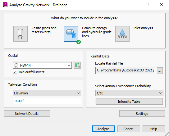

There are three analysis types you can select: Resize Pipes and Reset Inverts, Compute Energy and Hydraulic Gradient Lines and Inlet Analysis.
The calculations are based on the Urban Drainage Design Manual Third Edition, Hydraulic Engineering Circular No. 22 (HEC-22), published by the US Department of Transportation Federal Highway Administration.

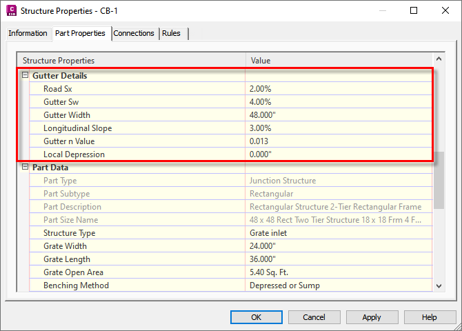

You can use the Channel Details section of the Structure Properties dialog box to define properties of the carriageway area around the inlet. These properties are used by the Analyse Gravity Network command for inlet analysis calculations.

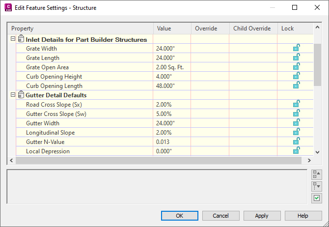

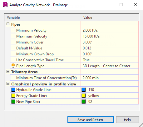

Settings that must be specified manually for the tributary areas and pipes, or which are used as values in the analysis calculations, can be pre-established as defaults on the Settings page. Click the Settings button on the General page to open this dialog box.
Default settings for structures can be specified in the Edit Feature Settings – Structure dialog box.

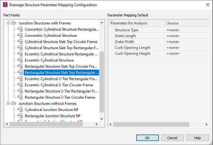

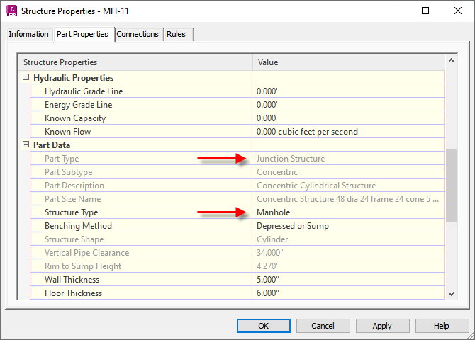

You can map the parameters of parts created with Part Builder to parameters that are required for the Analyse Gravity Network command.
By mapping the parameters and applying them to the structures in existing pipe networks, you will not need to manually specify the values when you are using the Analyse Gravity Network command.
For more information, see To Map Drainage Structure Parameters for Gravity Network Analysis.

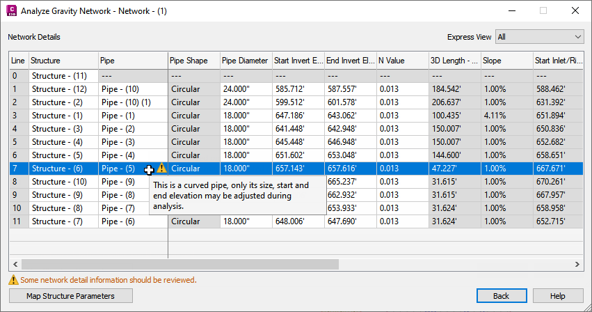

Use the Network Details page of the Analyse Gravity Network dialog box to review and change the network detail information that is relevant to the selected analysis types.
If the analysis type you select cannot be performed, an error message is displayed below the Network Details button on the General page of the Analyse Gravity Network dialog box.
If some of the network detail information should be reviewed, a warning message is displayed below the Network Details button on the General page.
Click the Network Details button to open the Network Details page where you can review errors and warnings and change the network detail settings.
For more information, see Network Details Page (Analyse Gravity Network Dialog Box).

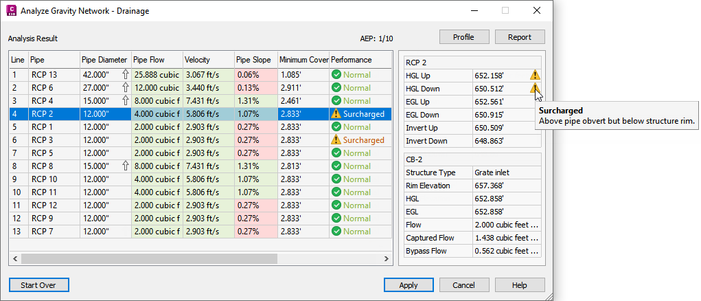

When you click the Analyse button in the Analyse Gravity Network dialog box, the Results page is displayed.
Visual cues and tooltips are displayed to indicate the analysis results.
When you select a row in the results table, the right panel displays detailed information about the pipe and structure in the selected line.
For more information, see Results Page (Analyse Gravity Network Dialog Box).
