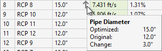

If the Resize Pipes and Reset Inverts analysis type was selected on the General page and a pipe diameter was resized, this column will contain either an up arrow or a down arrow. When you place your cursor over the arrow, a tooltip is displayed that explains how the pipe was resized.

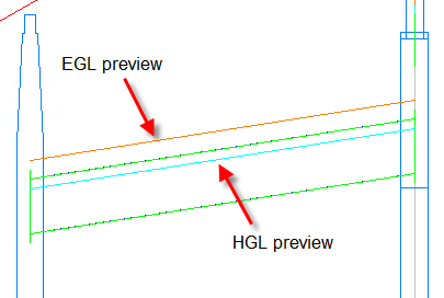

You can zoom and pan to an existing profile view to see a preview of the EGL, HGL and pipe changes. The colours shown in profile view are specified in the Default Settings page, which you can access from the General page of the dialogue box.

The following illustration shows a detail of the EGL and HGL lines in the preview.
