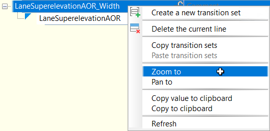

You can right-click a transition or a transition set to access commands on the context menu.
To add a comment for a transition set, click in the Comment area in the transition set row and enter the comment.
To lock a transition set, hover your cursor over the Parameter column in the transition set row to display the lock icon and click it to lock the transition set.
