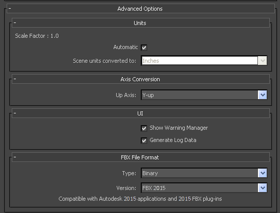

Advanced Options
The Advanced Options rollout primarily contains additional options that let you modify the default plug-in behavior. In most cases you do not need to modify these options to have a successful export. The section also holds additional settings specific to the Collada file type.
Units
The following rollout includes unit settings for your exported files.
Automatic
Activate the Automatic option if you want the 3ds Max FBX plug-in to automatically identify and set the units of the destination file to match units of the host application
When you activate Automatic, the Scene units converted to option is disabled, although it shows the resolved unit & Scale Factor. If you disable the Automatic option, the Scene units converted to option becomes available.
When Automatic is active, the File Units will match the system units, and the plug-in applies no conversion. The displayed Scale Factor is 1.0 in this case.
Scale Factor
Displays the conversion value or Scale Factor that the plug-in applies to the entire scene during export.
By default, the 3ds Max FBX plug-in uses the system units set in the host application to determine what units to use to export the FBX file. This means that the default export Scale Factor is always 1.0, and the plug-in applies no unit scale conversion during the export process.
You can modify what units the 3ds Max FBX plug-in uses to export your scene if you change the Scene Units converted to option. If you change the Scene Units converted to option, you modify the Scale Factor value and units applied to the exported data.

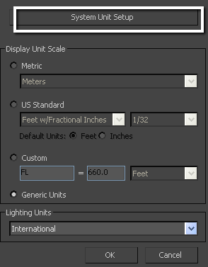

Scene Units Converted To
Use this menu to specify the units to which you want to convert your exported scene. Modifying this setting directly affects the Scale Factor value applied to the exported data.
The plug-in determines the default units by looking at the System Unit Scale in the System Unit Setup dialog box in 3ds Max.
Note: To view the default units, click System Unit Setup in the Units Setup dialog box that appears when you select Units Setup from the 3ds Max Customize menu.
On export, the plug-in applies no default scaling since the export and system units match. This results in a Scale Factor of “1.0”.

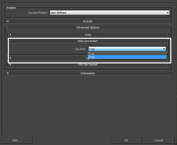

Axis Conversion
The FBX export plug-ins have two options for Axis Conversion, Y-up, or Z-up.
When you use the Autodesk Media & Entertainment preset, the 3ds Max FBX plug-in exports using the Y-Up Axis.
You can export your scene to a Z-up axis if the destination application does not support the Y-up world axis and cannot convert the Y-up world axis of your scene.
Note: The exporter applies Axis Conversions only to root elements of the outgoing scene. If you have animation on a root object that must be converted on export, these animation curves are resampled to apply the proper axis conversion. To avoid resampling of these animation curves, make sure to add a root node (dummy object) as a parent of the animated object in your scene, before you export to FBX.
UI
These options let you set display options of the UI, such as show or hide the Warning Manager.
You can customize these display options, save them as a new Preset, and share this preset file. See the Edit/Save Preset section for more information.
Show/Hide Warning Manager
This option lets you disable the Warnings and Errors dialog box that appears during the export process. The Warning manager is active by default.
Generate Log Data
Deactivate the Generate log data option if you do not want warning and error information written to the log. However, if you deactivate this option, the FBX Exporter/Importer records the file name and time stamp in the log file, but does not include error and warning data.

FBX File Format
This section lets you determine the format of your FBX file.
Type
Save your FBX file as one of these two types, binary or ASCII. While binary is the normal format for FBX files, ASCII files give you a plain text version of the file format, which lets you search the file for information retrieval.
