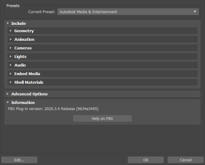

  3. Click Save. The FBX Exporter window opens.
  4. If you want, select a preset from the Current Preset menu. The Autodesk Media and Entertainment preset contains the best balance of options for a general animation workflow. See Autodesk Media & Entertainment Preset for more information.
    You can also select your own options for export from the FBX Exporter window. For more information about export options and which are appropriate for you, review the Export section.
