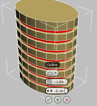

Detail the cylinder: Add windows:
Convert To Editable Poly.
All horizontal edges above and below the selected edge are also selected.
3ds Max displays the caddy controls for the Chamfer tool.
3ds Max changes each horizontal edge loop into a pair of loops 0.6 meters apart.

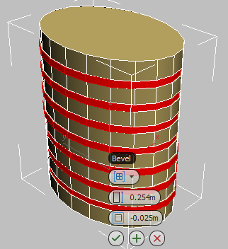

Detail the cylinder: Bevel the windows:
Show The ViewCube.
3ds Max displays the caddy controls for the Bevel tool.
(Polygon) to exit the Polygon sub-object level.
