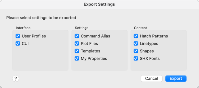

EXPORTUSERSETTINGS (Command)
Exports custom user settings for import on another machine. Settings can include user profile, toolbar and toolset customizations, command aliases, plot settings, templates, and the My Properties settings for the Property palette.
Access Methods
Menu: Tools > Export Settings
Summary
The Export Settings dialog box is displayed.
Setting File Type
User Profile .plist
CUI .cui
Command Alias .pgp
Plot Files .stb,.ctb
Templates .dwt, .dst, .dwg
My Properties UserPropertyData.plist
Hatch Patterns .pat
Linetypes .lin
Shapes .shx
SHX Fonts .shx
Enter a file name and a location for the export file.
