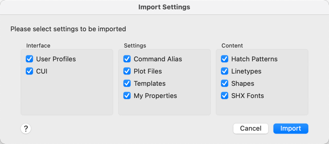

A file selection dialog box is displayed. Browse to and select the export file created with EXPORTUSERSETTINGS.
The Import Settings dialog box is displayed.
Setting File Type
User Profile .plist
CUI .cui
Command Alias .pgp
Plot Files .stb,.ctb
Templates .dwt, .dst, .dwg
My Properties UserPropertyData.plist
Hatch Patterns .pat
Linetypes .lin
Shapes .shx
SHX Fonts .shx
