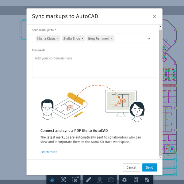

Sending Markups from Autodesk Docs (as a sender)
- In Autodesk Docs, in the Files tool, open a PDF with published markups.
- Select Sync markups to AutoCAD.
- Choose who will receive the markups and add any comments.
- Click Send.
Recipients will receive an email from Autodesk Construction Cloud with a link to the AutoCAD drawing.

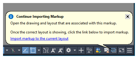

- Once AutoCAD opens, you're prompted to import the markup to a drawing layout (or model).
If AutoCAD is able to detect the drawing and layout associated with the PDF:
- The layout opens. Choose Import markup to import the markup onto a new trace. Or, if the currently displayed layout is incorrect, select a different layout onto which to import the PDF.
If AutoCAD is unable to detect the drawing and layout associated with the PDF:
You'll need to manually select the drawing and layout on which to import the markup.
- Open the drawing and layout onto which you would like to import the markup.
- Once the correct layout is displayed, click the link in the notification to import the markup onto a new trace.
