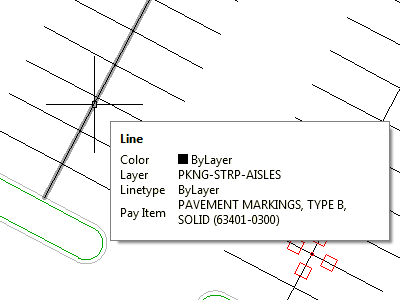

Assign a pay item code to linear objects
This drawing contains a commercial site, which consists of a building footprint, a parking lot, and access roads.
In the drawing, all parking lot stall lines are selected.
panel
Find.
You can also right-click the pay item and click Assign Pay Item.
The tooltip displays the pay item description and ID that has been assigned to that object.

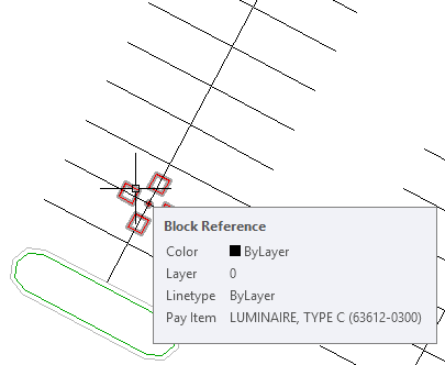

Assign a pay item to AutoCAD blocks
All the lamp blocks are selected.
The tooltip displays the description and ID of each pay item that has been assigned to that block.

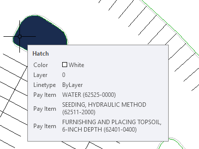

Assign multiple pay item codes to a closed area
To select multiple items, hold the Ctrl key down and then click the items.
This action activates object selection mode, in which you select the outline of a closed object, as opposed to a point inside the object. Because some of the parking lot islands are subdivided by pipes, you can use object selection mode to assign the pay item codes to the entire object, not only to the closed area that you select.
For faster performance, zoom in to a closed polygon before you select it.
A solid hatch pattern is displayed in the parking lot island. This indicates that the pay items have been applied to the area.
The tooltip displays the description and ID of each pay item that has been assigned to that area.
