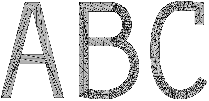

Standard (GLU)
The Standard (GLU) tessellation method is the legacy tessellation option; while being very light in its processing requirements, it is also the least efficient and precise. And compared to Delaunay and Medial Axis tessellation methods, it has no options to fine-tune the resulting tessellation.

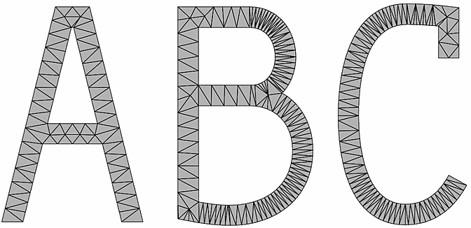

Delaunay
The Delaunay tessellation method (or more precisely, constrained Delaunay tessellation) generates a mesh composed entirely of triangular polygons. This method gives consistent and predictable results, and in particular, it does not give different results if the curves are rotated.
With this method, there are several options for fine-tuning the tessellation further.

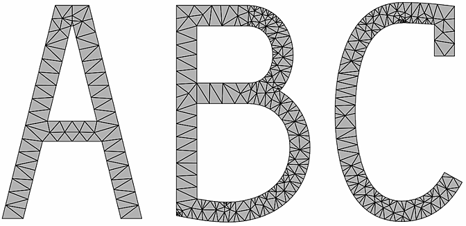

Min Angle field
Displays the smallest value of angle that the polygons can have. If a triangle contains an angle that is smaller than this value, it gets replaced by better-shaped ones. Eliminating small-angled triangles gives a more uniform shading and is more suited for deformations.
Min Angle = 20

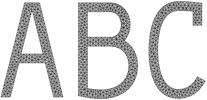

Max Area field
Displays the largest value of area that the polygons can have. If a triangle is larger than this value, it gets replaced by smaller ones. This allows the polygon mesh to be deformed more smoothly.
Max Area = 5
