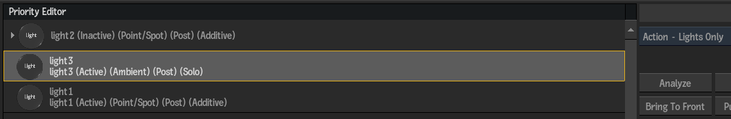

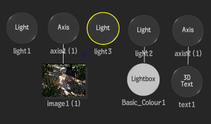

A common scenario that you may encounter when working with Lightbox is how to combine images that you don't want to shade with a geometry that you do want to shade. You can use selective lighting links and the Priority Editor to solve this issue.
Light 1 is a global light, set to Additive Light in the Light Source box.
Light 2 is the parent of the Lightbox node, and is not set to Active.

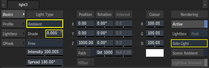

Light 3 is connected to the image node with a Light Inclusion link; the Light Type is Ambient, with the Shade set to 0%, and the Light source box set to Solo Light.
These settings, when combined with Light 3 appearing in the Priority Editor after Light 1, produces the desired effect.
