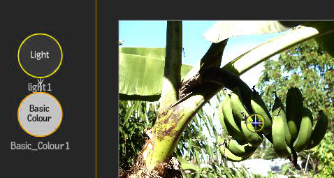

To add a Lightbox node in Action:
Do one of the following:
With a Light node selected in the schematic, double-click the Lightbox node in the All Nodes or Relighting bin.
The file browser opens to allow you to select a Lightbox effect. When selecting a shader from the file browser, you can use the File Format box to display shaders in .glsl format or encrypted Lightbox .lx format.
With a Light selected in the schematic, double-click a Lightbox preset node from the dynamic Lightbox node bin.
The Lightbox node is added to the scene as a child of the selected Light. If no light was selected prior to adding the Lightbox node, a new Directional Light is added to the scene as the parent of the Lightbox node.
Double-click the Lightbox node in the schematic to display its menu.
