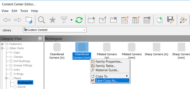

- Make a copy of the Plates family you want to add the hole to.
This example uses a metric end cap with chamfered corners.

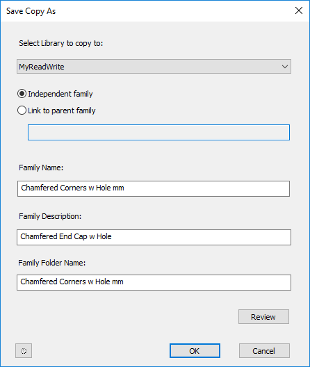

- Select your Read/Write library as the library to copy to, select
Independent family, edit the name and description fields as required, and then click OK.

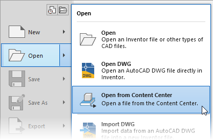

- Click the File menu in the upper left corner of the Inventor display and select Open from Content Center.

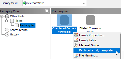

- Open the Content Center Editor again and make sure that the Library is set to your read/write library.
- Select the plate you saved in step 3, right-click and select Replace Family Template.
Note: If you use vault to manage Content Center, you must have either a Content Center Administrator or Content Center Editor role.
- Browse to the location you saved the modified plate with the added hole, select the file, and click Open.
The Publish was successful message indicates that your modified plate replaced the original copied file. Click OK and then Done to finish.
