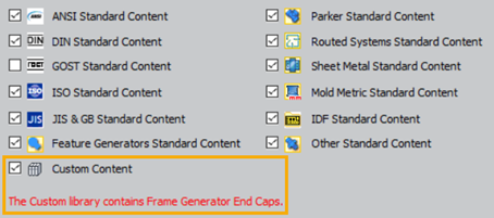

Important: Before you begin To use the End Caps command, the Inventor Custom library must be installed and selected for use in the active project.
  1. Install the Inventor Custom library.
  2. After install, select for use in the active project in the Configure Libraries: Project name dialog box.
    To Install and Add the Inventor Custom Library to the Active Project
    See Support Article for more details

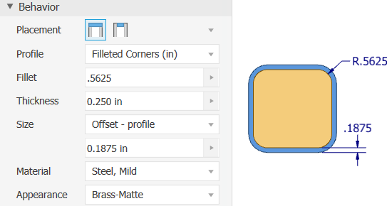

  5. Set the Behavior options:
    • Specify the Placement position.
    • Specify the Profile:
      • Filleted Corners
      • Chamfered Corners
      • Sharp Corners
    • Set the plate Thickness.
    • Set the Offset type and distance or ratio.
    • Optionally, set the following Part Properties:
      • Material
      • Appearance

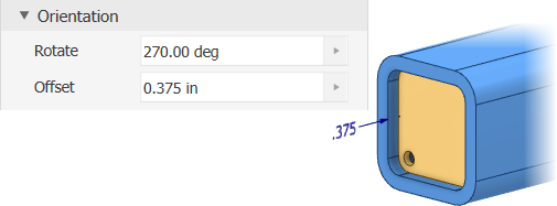

  6. Specify the Orientation.
    • Set the Rotate value. For example, to locate an end cap feature such as a drain hole in the correct location.
    • Set the Offset value. This specifies the distance between the selected face and the End Cap.
