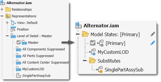

In the following image, the Master LOD is converted to the Primary model state. The user-defined LOD, and the Substitute LOD are converted to Model States with the same name. The three system-defined LODs that suppressed All Components, All Parts, and All Content Center are removed.
