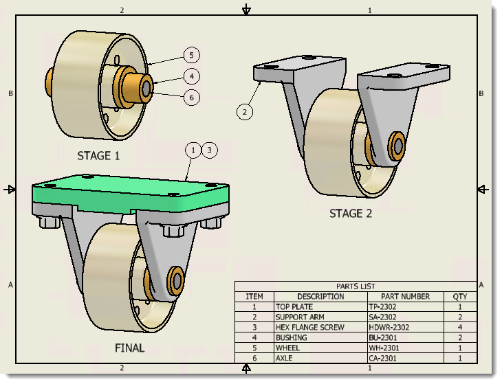

Model States in drawings
You can select a model state when creating a drawing view. Each model state can have unique members and iProperties. A view created from a Substitute model state reflects the state of the substitute part in the drawing view.
You can also select Design View and Positional representations, so that the combination is represented in the view.
After the view is created, you can edit it to change to a different representation, if appropriate.

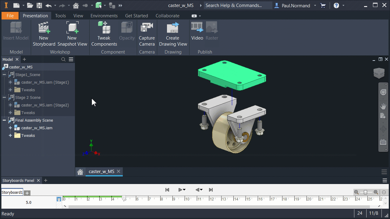

Model States in presentations
Like drawings and other assemblies, presentations use specified Model States.
In the assembly, create a model state entry and save the file. In a new presentation file, use Insert Model and browse to the appropriate assembly. Use Options to specify the appropriate model state.
Further, a presentation updates to reflect changes in the model state. For example, if you add tweaks in a presentation, and then edit the model state in the assembly to suppress more parts, when you return to the presentation, it shows the new state. If parts were deleted that participated in a tweak, the tweaks are deleted.
Note: A Substitute model state is a single part and cannot be exploded.

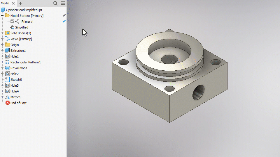

Create a simplified model state
Create a model state in a part file and suppress features to create a simplified model. This can be useful for simulation and analysis purposes.
Create a substitute model state in an assembly to use a part file in place of the assembly using one of the following techniques:
