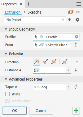

The Extrude command uses a property panel to define the feature. If you are not familiar with Inventor property panels, see About Property Panels
to learn about the workflow, behaviors, and advanced options, such as the panel menu and advanced settings. Keep in mind the selections you make in a section, determine the options presented in the next section, as you work from top to bottom in the property panel.

  1. On the ribbon, click 3D Model tab Create panel Extrude .
    If there is only one profile in the sketch, it is selected automatically. Otherwise, select a sketch profile.
  2. By default Extrude creates a solid body from an open or closed profile. You can also extrude a sketch as a surface body from an open or closed profile.
    At the top of the property panel is the breadcrumb. To the right of the breadcrumb select Surface mode . The selection determines the options presented in the property panel. The Surface mode state (ON/OFF) is saved with presets.

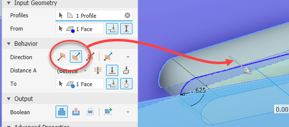

    • From - As the default, the extrusion starts from the sketch plane. To change the selection, in the From field, click the 'x' to clear the selection and choose a different starting plane. Work planes, sketch planes, and planar faces are valid input.
      • Between - use when extruding a shape between two faces. Select From and To faces, then select the Output type. The sketch doesn't have to be on either face.
        Note: If the solution isn't what you were looking for with the Default direction, click Flipped direction and toggle Alternate Solution to see additional solutions.
      • Extend face to end feature - automatically activates when the From selection does not intersect the extruded profile. You can also manually turn on or off the option. To turn the option off, click . The following is an example for how From and To are used together:

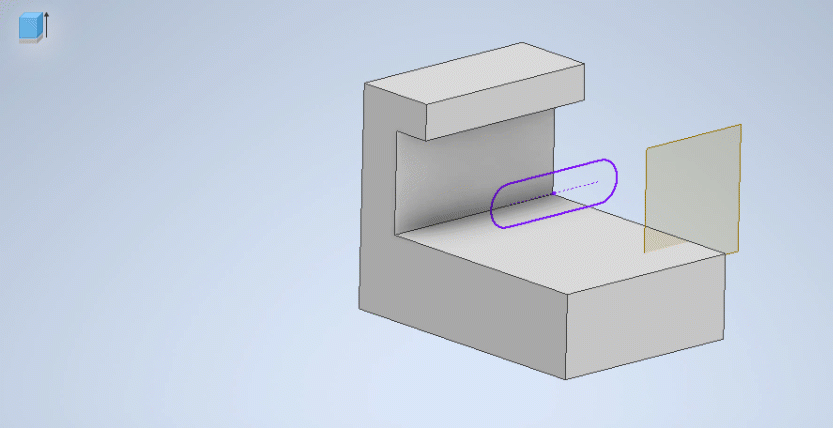

Create an extrusion terminating at a distance from a face
The profile sketch does not have to lie on the originating plane for the extrusion.
  1. Click 3D Model tab Create panel Extrude .
  2. If there is only one profile in the sketch, it is selected automatically. Otherwise, select a sketch profile.
  3. Select the face, work plane, or surface from which to start the extrusion. The option Extend face to end feature automatically activates when the From selection does not intersect the extruded profile. You can manually change the option.
  4. Specify the Behavior options, which could be direction and distance, to another face, and so on. Based on the selection the Terminate feature by extending the face option may be turned on. If the solution is ambiguous, such as when terminating to a curved surface, try applying the Alternate Solution option.
    Note: When working with a multi-body solid, you will need to specify the extrusion as part of another body by activating the Solid(s) selector and clicking the desired body or as a new body.
  5. Click OK or (Create new feature) to continue defining revolved features.
