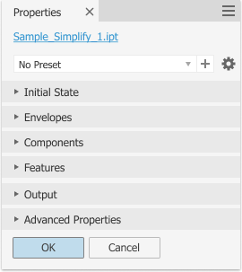

Simplify Property Panel
The property panel is composed groups of controls, input fields and selectors, that provide the means to reduce component and feature count in the simplified model. Groups display based on the options you specify as you work your way down the property panel.
Those groups are:
What each group is used for:
- Initial State - specify the Model State, Design View, and Position View to use for the simplified model.
- Envelopes - replaces components with an envelope based on the bounding box volume.
- Components - remove parts and components by explicit selection or use a bounding box diagonal measurement to remove components that fit within the volume.
- Features - remove features by type and/or size. You can also preserve selected features.
- Output - there are three file output options, new IPT file, new Substitute IPT file, and new RVT file. The filename appears in the breadcrumb at the top of the property panel. Within those file types there four style options.
- Advanced Properties - less frequently used settings for managing the simplified model being output.
