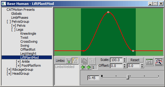

CATLiftPlantMod : FloatController {46606abf,2d3676}
This is a CATMotion controller used in the animation of Limbs in 3ds Max CAT.
Other controllers used for CATMotion Limb Animation include CATKneeAngle : FloatController and CATLegWeight : FloatController.
