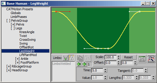

CATLegWeight : FloatController {7c125bf5,3a880ece}
This is a CATMotion controller used in the animation of Legs in 3ds Max CAT.
Other controllers used for CATMotion Limb Animation include CATKneeAngle : FloatController and CATLiftPlantMod : FloatController
Constructor:
Class instances not creatable by MAXScript
Aliases:
CATLegWeight LegWeight
Properties:
<CATLegWeight>.CATBranch : maxObject
Get/set the Branch controller.
<CATLegWeight>.LimbData (CATLimbData) : maxObject
Contains the LimbData controller object.
<CATLegWeight>.LiftStartTime : float
Get/set the Lift Start Time value.
<CATLegWeight>.LiftEndTime : float
Get/set the Lift End Time value.
<CATLegWeight>.PlantStartTime : float
Get/set the Plant Start Time value.
<CATLegWeight>.TroughTanLength (PlantEndTime) : float
Get/set the Through Tangent Length value.
