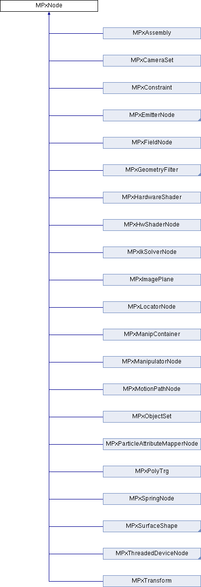

Inheritance diagram for MPxNode:Public Types | |

Base class for user defined dependency nodes.
MPxNode is the the parent class for user defined dependency nodes. A dependency node is an object that resides in the dependency graph. It computes output attributes based on a set of input attributes. When an input changes, the compute method is called for each dependent output.
The dependency graph is made up of nodes that have connections between their attributes. When an attribute changes, recomputation propagates through the graph until all affected values have been updated.
