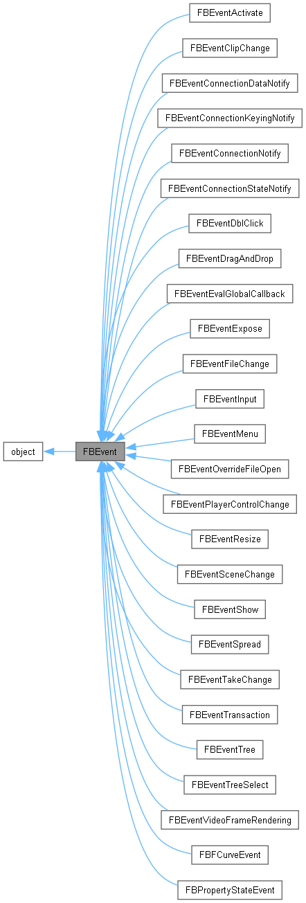

Base Event class. More...
#include <pyfbsdk_generated.h>
Public Member Functions | |
| FBEvent (HKEvent pEvent) | |
| Constructor. | |
Public Attributes | |
| int | Type |
| Read Only Property: Type of event. | |
Base Event class.
| FBEvent | ( | HKEvent | pEvent | ) |
Constructor.
Receives an object of type HKEvent that the corresponding callback will receive as a parameter.
| pEvent | Internal event to obtain information from. |
| int Type |
