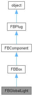

Global light class. More...

Additional Inherited Members | |
