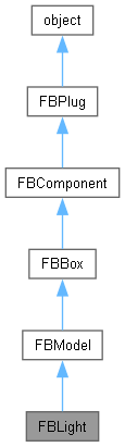

Light class. More...
#include <pyfbsdk_generated.h>
Public Member Functions | |
| FBLight (str pName) | |
| Constructor. | |
Public Member Functions inherited from FBModel | |
| FBModel (str pName) | |
| Constructor. | |
