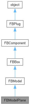

Plane model class. More...
#include <pyfbsdk_generated.h>
Public Member Functions | |
| FBModelPlane (str pName) | |
| Constructor. | |

Plane model class.
| FBModelPlane | ( | str | pName | ) |
Constructor.
| pName | Name of Plane. |
