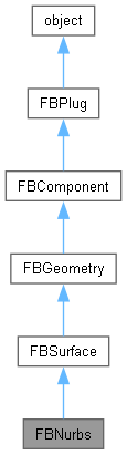

Nurbs class. More...

Public Member Functions inherited from FBSurface | |
| FBSurface (str pName) | |

Public Member Functions inherited from FBGeometry | |

Public Member Functions inherited from FBComponent | |
| FBComponent () | |
