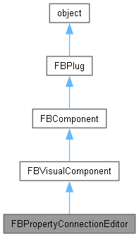

Property Connection Editor. More...
#include <pyfbsdk_generated.h>
Public Member Functions | |
| FBPropertyConnectionEditor () | |
| Constructor. | |
| PopupList () | |
| Launch a list of connected objects. | |
| PopupTree () | |
| Launch a tree of object connections. | |
