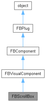

Scroll Box. More...
#include <pyfbsdk_generated.h>

Scroll Box.
This class provides a layout that will be automatically managed with a scrollbar according to the specified width and height. This provides a way to add dynamic UI control.
FBScrollBox | ( | ) |
Constructor.
