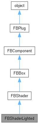

Lighted shader class. More...
This type of shader is the default type used by the application. It allows users to control luminosity, contrast and specularity as well as how the transparency is computed, should it be used.There are two methods to create a FBShaderLighted object: using the FBShaderManager, or simply by instantiating a class object explicitely.Please consult the application documentation for more infos on shader properties and their effects.This class should not serve as a base class for another class.Sample C++ code:
The following sample code does the same task, but in Python.Sample Python code:
