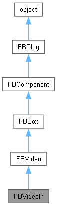

Basic video input class, supporting webcam and DV device. More...
#include <pyfbsdk_generated.h>

Public Member Functions inherited from FBVideo | |
| FBVideo (str pName) | |
| Constructor. | |
Public Member Functions inherited from FBBox | |
| FBBox (str pName) | |
| Constructor. | |

Public Member Functions inherited from FBComponent | |
| FBComponent () | |
| Constructor. | |

Public Attributes inherited from FBPlug | |
| str | ClassGroupName |
| ClassGroupName of the object. | |
| int | TypeInfo |
| TypeInfo. | |
