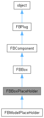

Wrapper around a specific instance of a FBBox object.
This class is mainly used with a constraint relation to have multiple boxes that are a representation of the same underlying box. The underlying box will usually be a device. Instantiation of FBBoxPlaceHolder should be left to the the system.
| FBBoxPlaceHolder | ( | ) |
Constructor.
| FBBox Box |
Read Only Property: Underlying box object.
