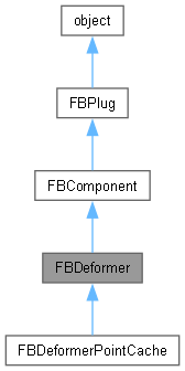

Base Model deformer class. More...
#include <pyfbsdk.h>
| FBDeformer | ( | str | pName | ) |
Constructor.
| pName | Name of deformer. |
| FBDeformerType DeformerType |
Read Only Property: Deformer Type.
