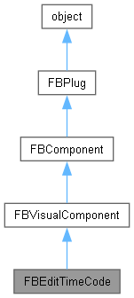

#include <pyfbsdk.h>

Public Member Functions inherited from FBVisualComponent | |

Public Member Functions inherited from FBComponent | |

Public Attributes inherited from FBVisualComponent | |

Public Attributes inherited from FBComponent | |

Public Attributes inherited from FBPlug | |
