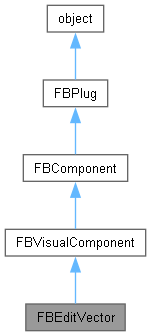

Vector edit widget. More...

Vector edit widget.
| FBEditVector | ( | ) |
Constructor.
| FBEvent OnChange |
Event: Vector value changed.
| FBVector3d Value |
Read Write Property: Current value of vector.
