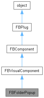

Folder Popup (for selecting a directory). More...
#include <pyfbsdk.h>
