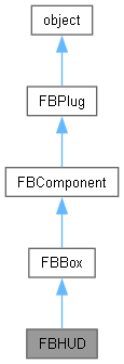

Heads Up display. More...
#include <pyfbsdk.h>
Public Member Functions | |
| FBHUD (str pName) | |
| Constructor. | |
| FBHUDElement | CreateCustomElement (str pHUDElementClassName, str pName) |
| Creates a custom HUD Element. | |
| FBHUDElement | CreateElement (EStockElement pType, str pName) |
| Creates a stock HUD Element. | |
