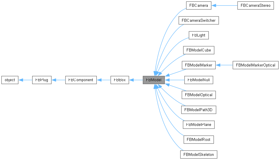

Inheritance diagram for FBModel:

Detailed Description
Model class.
In the MotionBuilder UI, a model can be any object in a scene, created using geometry. Models can represent simple objects like cubes, or complex objects like characters.FBModel is a base class which is not used so much directly, but is the parent of well-used classes like FBCamera, FBLight, and FBModelMarker.It also implements a number of widely-implemented functions and attributes, such as: Clone(), FBDelete() UI attributes such as Show, Pickable, and Visibility Positional attributes such as Rotation, Scaling, and Translation The following Python snippet shows how to create, show, rotate, and delete a cube
from pyfbsdk import *
myCube = FBModelCube("cube")
myCube.Show = True
myCube.Rotation = FBVector3d(45, 45, 45)
myCube.FBDelete()
Cube model class.
Definition: pyfbsdk.h:13000
