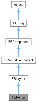

Inheritance diagram for FBPopup:

Detailed Description
Popup window.
This class lets a window (inheriting from FBLayout) be created for another interface.
See sample: Popup.py.
