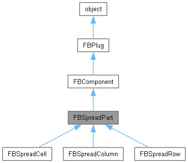

Inheritance diagram for FBSpreadPart:

Detailed Description
Spreadsheet part.
Due to protected constructor, this can only be created by a child object.
