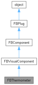

Thermometer. More...
#include <pyfbsdk.h>
Public Member Functions | |
| FBThermometer () | |
| Constructor. | |
| Clear () | |
| Reset bounds and value. | |
