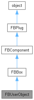

FBUserObject Class Reference
#include <pyfbsdk.h>
Inheritance diagram for FBUserObject:
