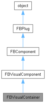

Inheritance diagram for FBVisualContainer:
