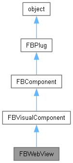

Web viewer. More...
#include <pyfbsdk.h>
Public Member Functions | |
| FBWebView () | |
| Constructor. | |
| Load (str pURL) | |
| Load the specified Url. | |
Public Member Functions inherited from FBVisualComponent | |
