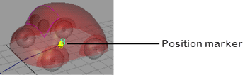

To create a position marker
The object moves to that position on the motion path.
If you see a yellow box at the marker, it is a position marker.
