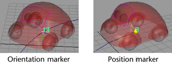

There are two types of motion path markers:
Each position marker has a U value that represents the marker’s position on the path, ranging from 0 at the start to 1 at the end. After creating a path animation, you may decide to change the object's start point on the path, the end point, or the speed of travel between key frames. You can slide position markers along the motion path, or adjust their Time values in the Attribute Editor.
Each orientation marker records the Front Twist, Side Twist, and Up Twist rotation values applied at a key frame along the path. These Twist values are added to the default rotations computed by the path animation when you use the Follow (and optionally Bank) options. You cannot slide orientation markers along the path, but you can adjust their location by changing Time values in the Attribute Editor.
