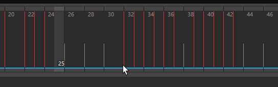

Copy and paste a single key
Copy and pasting a single key on the Time Slider
- Shift-select a key in the
Time Slider.
The Current Time Indicator moves to the clicked position and the key is highlighted blue.
- Do one of the following:
- Hold
Ctrl and right-drag the selected key to a new position on the Time Slider.
- Right-click and select
Copy from the menu that appears.
- Select
- Click in the
Time Slider.
The
Current Time Indicator moves to the clicked position.
- Select
from the
Key menu.
- Shift
S + click and select
Paste Keys from the
marking menu that appears.

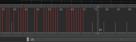

Copy and paste multiple keys
Copying keys on the Time Slider
- Shift-drag over the range of keys in the
Time Slider.
The range of keys is now selected and highlighted blue.
- Hold
Ctrl and drag the selected keys to a new position on the
Time Slider.
- Select
Time Slider that you want the pasted keys to be added to, to replace, or to merge with.
The range of time is now selected and highlighted in blue.
- Press and hold
Ctrl while dragging to a new position on the
Time Slider.
- Select
from the
Key menu.
- Shift +
Paste Keys from the marking menu that appears.
