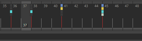

Copy a key set on a scaling curve (green) on the Time Slider
To copy keys on the Time Slider
- Select the keyed object.
- Right-click the
Time Slider and select
Color Coded Keys from the
Animation controls menu. The key ticks show color beads to represent each curve, blue for translation, yellow for rotation, green for scaling, and white for other.
- Shift-select the key and press
Ctrl to copy it to a new place on the timeline.
